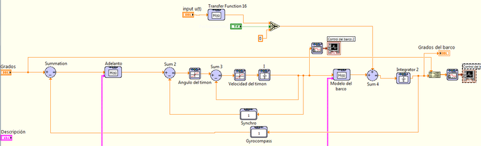

Hi, I designed a rudder control system on LabVIEW using only simulation tools like: transfers functions,  step signal who simulates my input into the system and feedbacks where simulates the sensors. Now, I have to move this design to myRIO and use NI controllers as CompactRIO, beside I must do the interface for the customers on a touch panel and my sensors will be simulated on it.

I have this:
I need to do a pitch where a present this project and they decide either is achievable or not, so I have to do it on MyRIO using a National Instrument's controller and also put some parameters from a touch panel like a HMI as the angle desired that requires the captain or helmsman, simulate Gyrocompass and Syncro's sensors on it

Imagine two computers and MyRIO.  So, My first computer will be the interface where the user can interact with the "ship". Then, MyRIO will be my controller and it'll have leag and fuzzy controller. Finally, the second computer will be my simulator and it will have the behavior's ship (the equations) and the sensors
