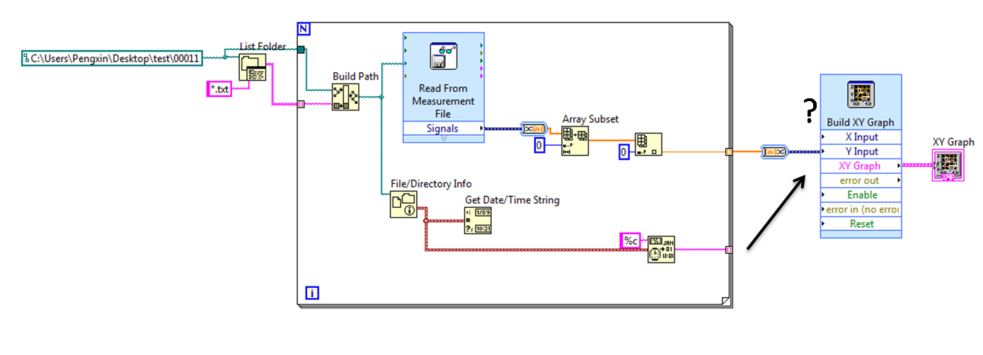

I wanted to plot out my data by looping all the text file in a particular folder. I am able to read all the data for the Y axis. Now i wanted to plot the X axis for each data point. The X axis data point will be retrieved from the time it is being generated.
I do not know how to input this information into the x axis of the XY Graph. Please help me on this
Please see the Picture Below

This is the code and the result. The x axis is wrong because of the localized time format difference.

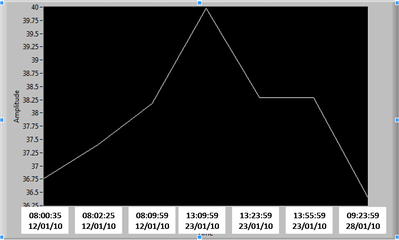

Ideally i wanted the y axis for each data point to be at the same interval, and at the bottom of the graph will show the date it is generated. The attached picture is the example that i drew out.

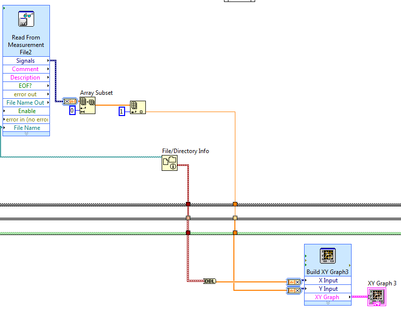

This is kind of what I had in mind. The waveform data type does not have to contain multiple points. In this case, it's just a different way to represent the evil dynamic data you are using.
Experiment a bit with the arrays that you get. You might need to transpose and/or extract a column. I don't have multiple files so that is up to you. I also did not convert the timestamp to dbl. That will also be up to you.

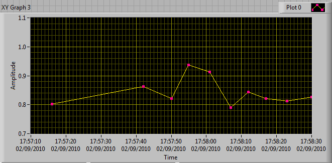

I manage to create it finally. Thank you very much. The first picture will be the VI i made.

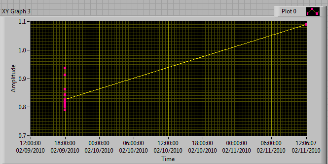

However, there is some improvement i would like to make. Looking at the 2nd picture, this is the result of the VI then i run. It can clearly display the result over time. If i had added one more data point which was taken another day ( Look at Picture 3, from 09 Feb to 11 Feb), then the the trend line will be compress to such and it will not longer be meaningful to user to see how the trend changes.
I want to ask whether it is possible to remove the interval between those data points, or saying that the interval between data point to be plotted out will be the same ; at the same time it still can show the time at the x-axis when this data point is generated.
