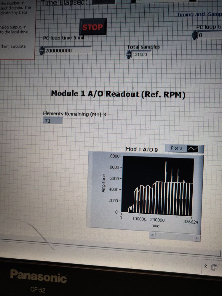

I'm acquiring RPM data on a cRio 9014 with the 9118 chassis, with an NI 9201. Eventually we will collect 5 pieces of data, RPM, Speed, Torque, Voltage and Current all connected to the NI 9201. Something interesting is happening when we're trying to collect RPM data.
IMG_20190128_170203.jpgWe have an array of 8 here indexing from 0, responding to analog inputs 0 to 7, with 7 being the RPM sensor. When we try to obtain data with the program like this, our graphs are filled with "noise" and zeroes itself down, etc.  For example, here is a graph where I increased the motor RPM from 0 to 6000rpm and held it still for a solid 5-10 seconds. You can see the graph increase, and then flatten out at the top but still have spikes here and there.
What could be causing this?

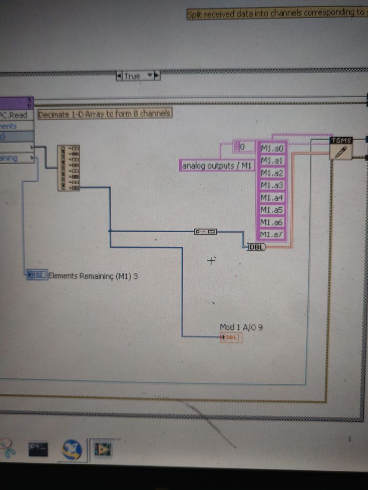

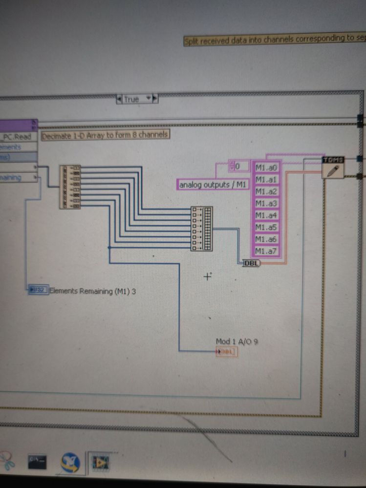

also, something interesting, when I disconnect all the other analog inputs right before the TDMS file write method, the program works a lot better.

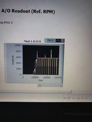

so for timeout control, for 5 sec, i would have 200000000 clock ticks. Just tried that and while it's a little cleaner, we're still getting ups downs and etc. Did I do the math correctly?  anything else that could be the problem?
