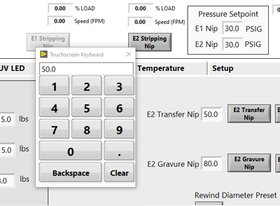

I am designing an HMI that will be run on a touch screen computer with no keyboard or mouse.  I have integrated a 3rd party add-on that can be found here:
https://www.ni.com/en-us/shop/product/touchscreen-keyboard.html
I am trying to setup all my front panel interactions using an event structure but sadly when entering data using this touch screen add-on it doesn't trigger an event when a value is changed.  Does anyone have a suggestion on a work around?  Or maybe a different touch screen keyboard.  I just included a screenshot of a portion of my front panel with the touch screen pop-up.  It activates when you tap on any front panel control and brings up either just a number pad (as shown) or a full keyboard for string fields.
Any suggestions would be appreciated.  Thank you.
-John

Without seeing the code, and knowing what problems typically trip people up with event structures, I'm going to guess that the event cases are set to Lock Front Panel until the event completes, and that is blocking further user access.

Honestly, it sounds like it's working as intended.  I would expect a keypad to pop up for a numeric input, and a keyboard for a string input.  How else would you enter data with a touch screen?  Unless this happens when you press a button as well.
Edit:
Waitaminit, how do you exit the keypad when you're done?  There's no <Enter> button.
Bill
