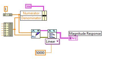

Well i mean..
is it possible to build a filter that has a magnitude/frequency response  which follows the course of a curve (a frequency response) that has a well know formula??
Thank You
