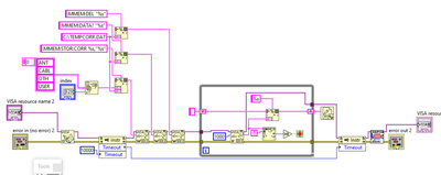

@ohboy5678 wrote:
duplicated what you created but goes into the loop at the read point and does nothing.  ☹️
You'll have to do some reading in the programmer reference manual and then some debugging. And watch out for typos and such. I do not have this device available so I can't check it. You may also want to experiment with adding an Error Query after the first command write, but not after the second or later as that might conflict with the data from the DATA? command.

Seems to work now that I have it saving to a file.  So the question is how do I do the reverse and upload a file to the machine?  I attached that I pulled from the machine.  I can obviously save it in any format.  I already have an excel program that will create the file format that is necessary for the machine to recognize.  Just need to upload it.
