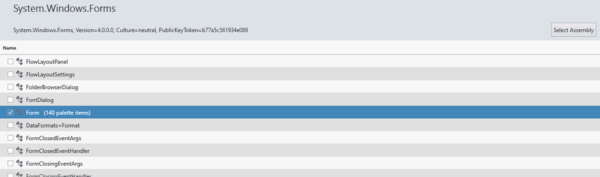

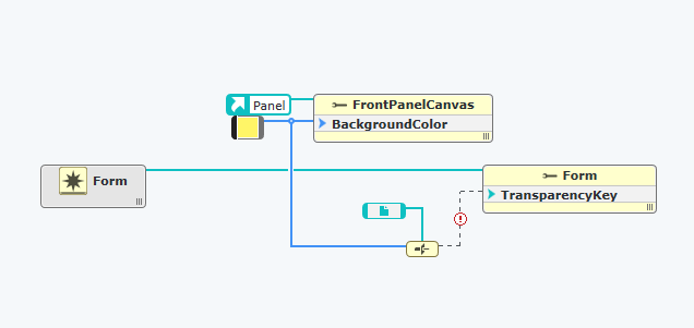

So far I have tried this approach, but not sure if this is the correct way:

NXG is built around Windows Presentation Foundation (WPF) rather than Windows Forms, so unfortunately the Form.TransparencyKey won't work. There are WPF's Opacity and OpacityMask properties, but that requires getting access to the front panel canvas as a System.Windows.UIElement class, which isn't exposed on the block diagram.
You may have better luck with win32 functions such as those in the attached VI (it can be imported into NXG with the code conversion utility). I did try running the attached VI against NXG, but it didn't seem to work. It found a valid window reference, but the transparency setting didn't have any effect. I suspect it's because it uses SetLayeredWindowAttributes, where it should probably use UpdateLayeredWindow. See this blog post for details on how WPF handles transparency.

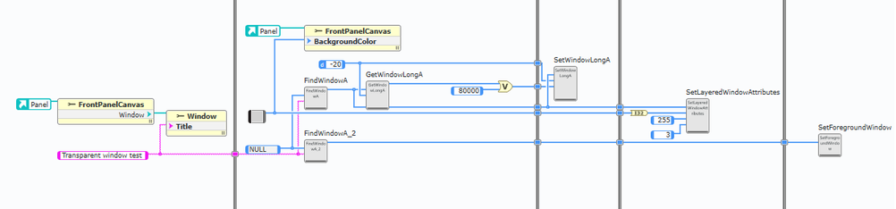

Here is the block diagram:

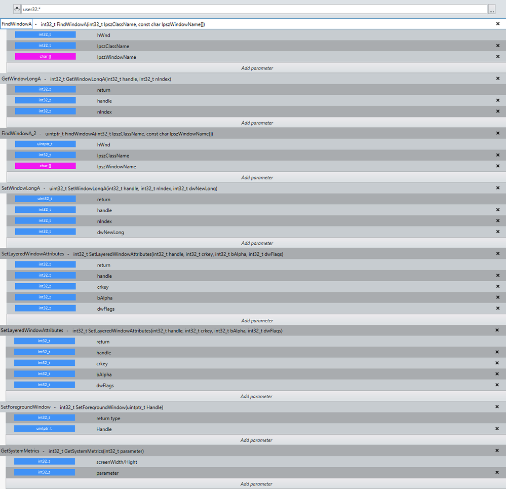

With the following "Shared Library Interface:
