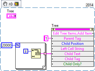

Yes, but again, I don't see this ever looking good:
If the numbers in this example are floating point values instead of integers, you would need a severe case of savantism to read anything from those values....
However, it seems to be possible to have 20.000 columns
