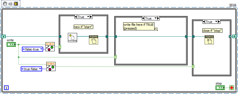

Message 8 of 12
(4,394 Views)
Here it is
Message 9 of 12

Accepted by topic author Tanieta
