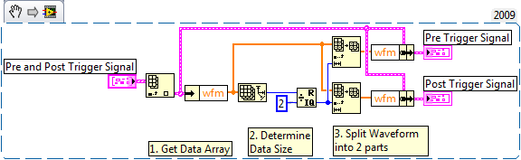

Have you tried taking the original signal with pre and post trigger data and simply split the array in half?  It will take a couple of functions to do this, but it's a pretty straightforward task.  For Example:
Message 2 of 9
(5,300 Views)
Thank you so much, I'll try that out immediately.
