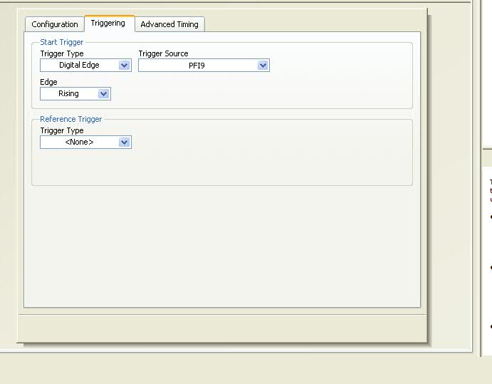

Hello Theo,
Thankyou for your post.
The NI 6259 supports both analogue and digital external triggering. In LabVIEW, if you right click on the DAQ Assistant and go to properties, there is a triggering tab you can use. Click on the tab and under Start Trigger there is drop down boxes for Trigger Type, Edge and Trigger Source. From the information you've given I would set it up like this (screen shot below), though, you can change the settings as you please e.g. the Edge can be changed to falling.
Let me know if this helps

Rico,
Many thanks for the reply. Sadly, I've been there already!
I'm familiar with the triggering tabs you showed, however if you set up the DAQ assistant for frequency measurement, those tabs no longer appear.
I'm beginning to wonder if it's just not possible to do a triggered frequency measurement with this board? (By the way I also have a 6133 board, can anyone tell me if either - or neither! - of these boards can be configured to do what I need?)

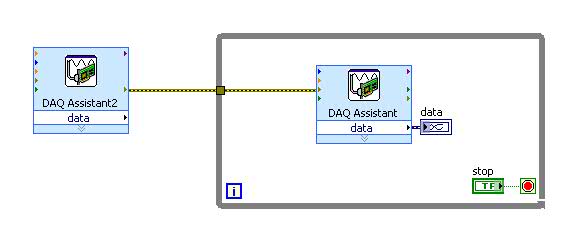

Hi Theo,
I've been experimenting with using triggering for acquiring frequencies. It turns out that you are correct and both can't be used at the same time. However, this applies for hardware but you can always make a work around using software. I would only do this though if the time between the trigger and the start of the acquisistion isn't to crucial.
Below is a quick work around I put together. I used a DAQ assistant with a digital trigger and then after put the DAQ assistant that you would be acquiring the frequency with. The first DAQ doesn't matter what signal it's set to because it's just being used to look for a digital trigger, so I set it to acquire analogue voltage.
So the DAQ assistant on the left is the one looking for a digital trigger and the DAQ assistant on the right will aquire the data after the trigger.
I hope this helps, however, if the timing between the trigger and the start of the acquisition is critical then I will look for a better solution.
