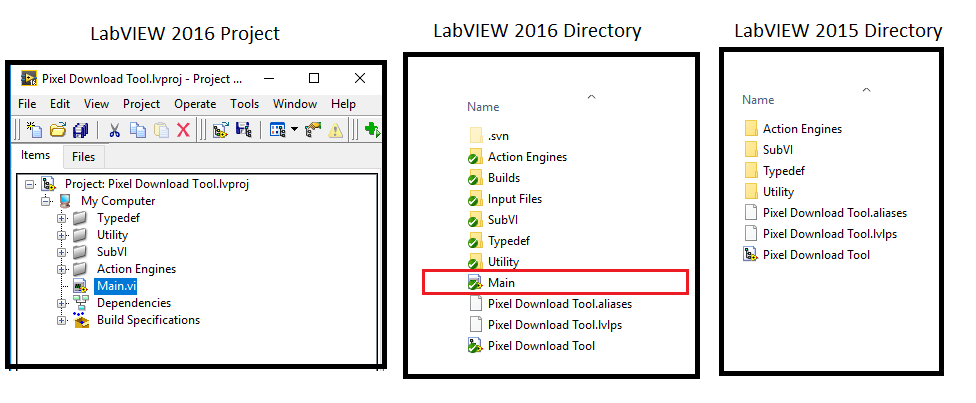

I am trying to save a project in LV 2016 for LV 2015. I have used file >> save for previous version... a lot in the past, but until recently I was using LV 2012 and 2014. Now I am trying it in LV 2016, and for some reason it saves most of the support VIs, but my top-level VI is nowhere to be found! If I open the newly created LV 2015 project, I can see that the Main VI it links to is still located in the 2016 folder. Is this a known issue?

I also found if I open up the Main VI and click save for previous version... (instead of from the project), then LabVIEW becomes unresponsive and crashes.

If I delete some things, sometimes it appears to save ok. I know that's vague, but it is not repeatable. My first thought was to delete all property nodes, and it worked. Then I got a fresh copy from SVN and did the same thing, and it didn't work. The only thing that works every time is to delete the entire block diagram, then it will backsave my Main vi, but of course this is useless.

I had given up on this for a while, because I was able to upgrade LabVIEW from 2015 to 2016. However, now I have another system to run the application on in LV 2012. Copying the block diagram into a fresh VI did not work, the fresh VI does not get backsaved now.
