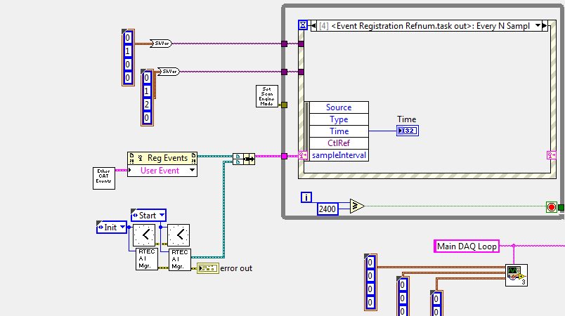

you can bundle dynamic event reg refnums into a cluster, and wire that cluster into the event structure.

SUCCESS!
I originally had the DAQmx REGISTER function after the task config and before the START.  But in all the fumbling around, I had moved it to AFTER the start.
LESSONS LEARNED:
1... Cannot register events on a task that has been started.
2... Cannot combine a DAQmx Registration with a user registeration. (Still don't know why).
3... Pay attention to where the dang thing is running!
Thanks, everybody!

Again, haven't watched the jings because I'm lazy Smiley Tongue, but my guess is it's somehow due to the strict typing of the wires. It is because of this strict typing that I always use bundle, with each dynamic event refnum representing only a single event, not multiple events with an expanded registration node, serialized registration nodes with the dynamic event reg refnum wired through them all, etc. Only PITA is that unregister doesn't accept the cluster even though dynamic event terminals do Smiley Mad.
