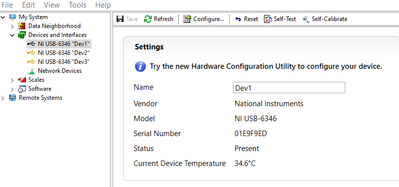

 I apologize for the late replies, but for the update, I was able to download NI-MAX into the computer and found this:

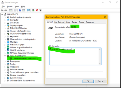

You have no COM ports.  That's why you can't use a serial connection.
If you have a desktop PC, almost all of them should have COM1.  If you're using a laptop, then you need a USB to Serial adapter.
Check your Device Manager too.  You should see the hardware under the Ports (COM & LPT) section:
Until Windows can see it, NI-MAX and LabVIEW won't be able to either.
