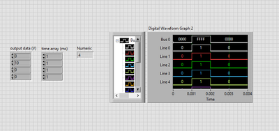

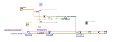

I am trying to write a boolean waveform to a PCIe-6536 board with DAQmx. When I run this program, the correct data is being written to the waveform graph, but it's not getting through to the board itself. Does the PCIe-6535 board accept a waveform? What am I doing wrong? I double checked the board with NI MAX, so I know the board itself works.

  1. Does the "Dev1/port0" & "Dev1/port1" is PCIe-6536 ?
  2. What's the function in the red circle? ( https://natinst.my.salesforce.com/sfc/p/i0000000jTAB/a/3q000000CsJk/CFf1TpP7pi1YH9qGfVFA8gwwcWZb77n2... )
  3.  Would you mind share your VI? Although I can't help you modify your VI due to privacy issue, but I can help you identify where's the error.

1. You are stopping the task immediately after starting it.  You need some time delay or loop in between to give the task time to run.
2. I don't use digital waveforms much, but I'm not so sure that your task config of "1 channel for all lines" is compatible with your attempt to write a 1D array of waveforms.  Have you probed for errors?  Run in execution highlight mode to see where they occur?
