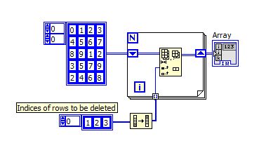

This is exactly what I'm looking for. Thanks you all. The picture below should be what you meant.
