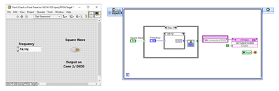

I am using a PXI-7842 FPGA module.  I'm trying to output a 10MHz square wave on one of the DIO channels. I am using the Square Wave Generator VI from the FPGA Functions pallet.  I get a somewhat decent square wave up to 1MHz, but at 10MHz, it's a sawtooth wave form.  I am using the FPGA's onboard 40MHz clock. How can I get a cleaner waveform?  Or are there frequency limitations?

Here is the code I'm using.  I've also attached a copy of the VI.  It is a fairly straight forward program.  I'm simply using the supplied function "Generate Square Wave.vi".  I've also attached pictures of the waveforms, using a Tektronix TDS 3034 oscilloscope.
