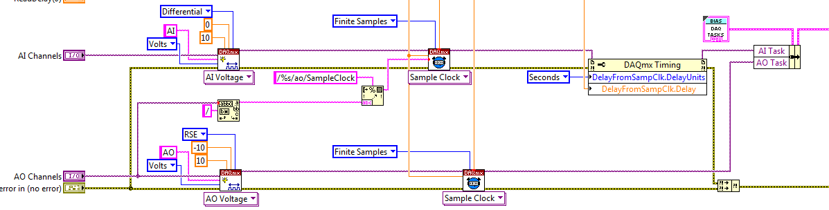

Did you do anything in your code to synchronize the cards? I'll warn you right off the bat, I'm not familiar with FPGA or your NI cards, but I have made two tasks use the same clock before. Using the DAQmx Timing (Sample Clock) VI you can share the clock from one card with the other. In my case, I want the AI to be triggered off the AO card, and did it like this:

gregoryj shows a good general idea how to synchronize two devices i.e devices need to share a common clock and start trigger.
However the code shown is for DAQ devices using DAQmx API, programming on FPGA is different. In order to synchronize two R series cards with a RTSI cable you will need to connect RTSI cable between two cards (this PLLs their on board clocks) and add a RTSI trigger as shown in this KB
