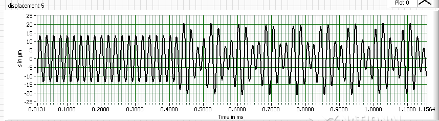

I know how to creat a sin wave and I know how to creat a modluated signal out of to different sin waves.
but I want to creat a modulated signal where the HF signal is starting later.
So first you have the low frequency sin wave and maybe after one sec. the high frequency signal will be modluated on top.

you are right. that is what I want to do!
I want to simulate a modulated signal. but i want to show how it looks like when the modulation is not starting at t=0.
I attached a draft   i hope that can help.
but the problem is, that I do not know how to tell the software, that the modulation should sart later.

There are many ways to approach this.  The architecture may depend on how you interface with the software (User Interface) and the level of interaction with it.  After saying that, I am thinking of Architectures, such as Event Structures, Producer/Consumer Loops, State Machines..   Maybe a State Machine could do the trick..  However, before suggesting something, I have a question.
Can the modulator portion of the code receive a frequency of zero (0) while waiting to start the modulation?  So the result would be an un-modulated signal...  And when you activate the HF, you'd end up with the desired modulated signal?

It's a bit long to explain what you did wrong..
First thing.. STAY AWAY FROM STACKED SEQUENCES!!!    Sorry for shouting!  But I keep praying that NI will remove those horrible things! 😉
Stacked Sequences are annoying because they make you loose sight of the dataflow that goes on inside the code.  Forcing sequential actions is not a good thing in Labview.
Have a look at the attached code.  It will do what you wanted.  It can still be improved, such as changing the For Loop to a While Loop and have the graph update as run run the VI, instead of a fixed number of iterations.
