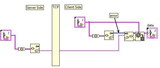

The "data string" which results from "variant to flatten string" is propagated to client software via TCP. On client side, settings are reconstructed using the same type definition.

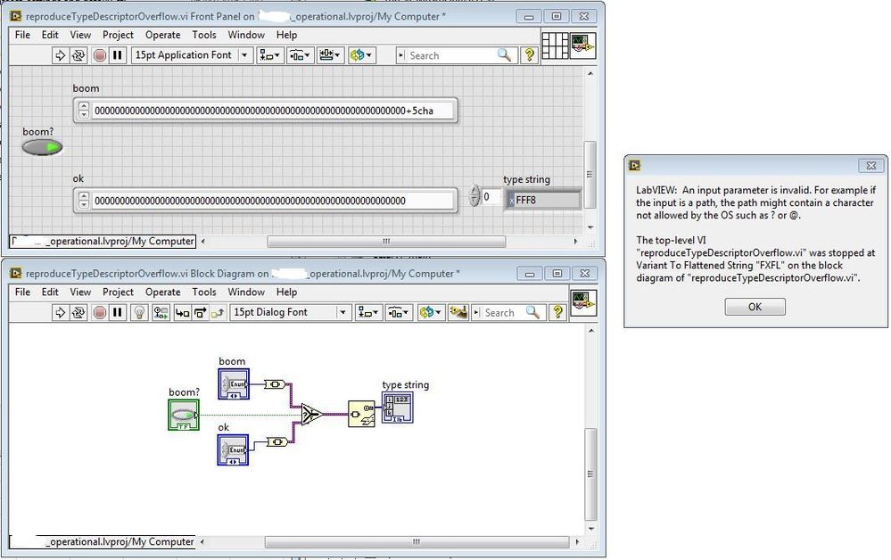

After removing some items from the enum, I identified that the value of the first word  of the "type string" was close to "FFFF". This correspond to  the number of elemental type descriptors contained in the type descriptor.  By adding more items, this would overflow.
Please see below and attached a reproduction of the problem:

That aside, is there a reason you're needing to convert both to variant and then string?  This seems like duplicated work unless you're doing something with the variants elsewhere in the application and you've pared that out just for this example.
