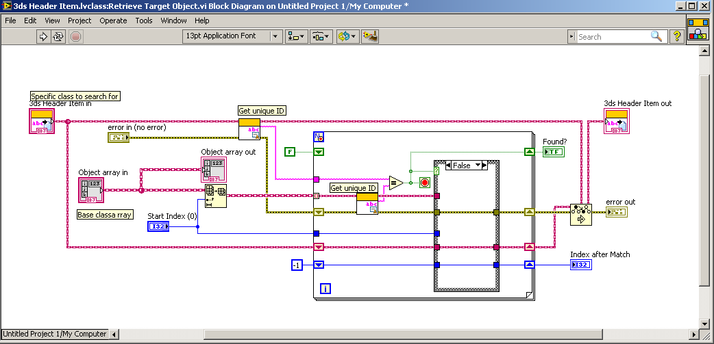

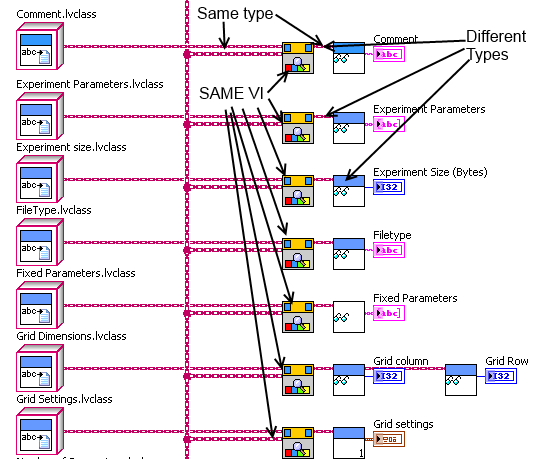

Oh lord no.  That's free.  If you wire an object type in on a non-dynamic dispatch input and connect this directly to the type of the "Preserve run time class" LabVIEW automagically updates the output type for you.  There IS NO CASE STRUCTURE.  That's the beauty of the solution.
Asusming all the classes have a UNIQUE identifier (This could also be an internal data field by the way) then there is no case structure.  The method to retrieve the unique ID is a must override of the parent.
This is how I do it at least.  When you do this, the input and output of this VI shown is the same type.
Warning: This image may confuse more than it helps.....
Message 6 of 19
(4,241 Views)

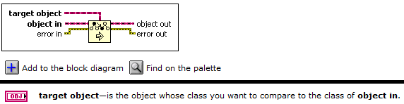

Ah, OK, i see what you refer to.
You require the target object to make this work. I thought that you would use class constants for this, so the Preserve Run-Time Class function had to be in a case structure, each case having a different class constant.
If using the class input of the subvi as target class, the solution does not need a case structure, but require the caller to pass a default object just as my code does.
Norbert

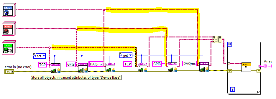

=> I could get the example to work with a single modification: when passing the correct output class to the device manager input ('get' action), it outputs the correct object class.
To my surprise I didn't have to modify my device manager, even no "preserve runtime class" was required. As long as the correct object type is provided at the input, the output is automatically casted to the same type.

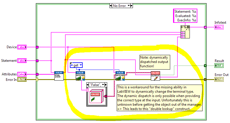

What I really tried was to create an interface-like behavior where I override an abstract method and just call the interface function without (!) knowledge of the concrete class type. The use case is an implementation of a TestStand based script interpreter where devices are dynamically registered at the beginning of the test. Succeeding steps just provide the deice id (a string) and some output statements. Depending on the device class, the appropriate output function should be called.
To make it short:
Your information really helped me out, as I can get the correct objects by making a double lookup (get the base object type, extract the class type from the base properties, pass it to a case structure with class constants, then repeat the lookup).
But finally Norbert is right:
Short answer:
It does not work because you work against the paradigms of LV OOP.
So this is a workaround that I don't really like, because of the additional lookups and the additional case structure in every wrapper VI. This makes it more difficult to extend the solution with more classes. I must confess, this is my second project using LVOOP, so I might have been a bit naive expecting such common OOP features like just calling an interface function without loosing object information. Let's call it paradigm, but in my LVOOP beginners eyes it's just an incomplete OOP implementation...
This is how the real use case (TestStand wrapper for an output function) now looks like:
