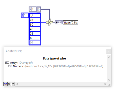

To start with, this isn't a "how to" question.  There are several options to do this, and I've already picked (and implemented) one of those options.  Instead, this question is "Hey, I tried something and it didn't work at all. What's going on under the hood in LabVIEW?"
So, I've got a widget that is a bit older and uses 12-bit integers on it's end. That data stream is converted into a byte array by the time it gets to me in LabVIEW, so I need to convert the byte array into an array of integers, splitting every other byte along the 4-bit boundary. My first impulse (and ultimately what I did) was to just use the data manipulation functions and move on with my life.
But then I thought "hey, I bet I could typecast my byte array into a 12bit fixed point array".  So I tested it.  Not only did it not work, the typecast spit out an empty array.
Anyway, my experience with using fixed points has been FPGA stuff, and pretty limited at that. Anyone want to shed some light on what's happening here?

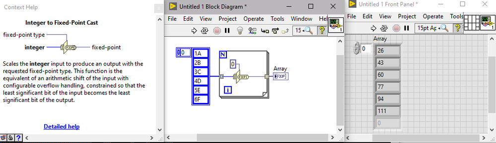

There is a specific function to convert to a fixed point number. It does not accept arrays, but easy enough to wrap it in a for loop.

Thanks for the response StevenD,
...but... I mentioned I already had a solution to the problem that I was happy with. That isn't my question.  (also, your solution doesn't solve the problem because it won't split the byte stream into 12 bit chunks - it's converting a u8 integer into fixed point)
Really my question is what's going on under the hood with the first typecast.  I'm interested in why it would return an empty array... I would have at least expected a return of some values, even if it wasn't in the format I wanted.  Notionally typecast is simply "Hey, here is a blob of bits in memory, and here is the definition of how to interpret those bits".  If that's what typecast did in LabVIEW, the typecast would have worked.
I think mcduff is the the closest: LabVIEW isn't simply saying "interpret these bits in this way". It tries to somewhat intelligently do the typecast.  Still, nothing I can find explains why I would get an empty array out of the typecast.
