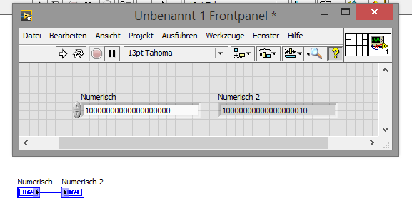

Hi jamiva,
thanks for your comment.
Two notes:
1) After the steps described before I cannot enter a value bigger then 1e19 in the control - atleast the display coerces as expected to 1e19.
2) When displaying the value of the control in an additional U64 indicator it shows the value is not coerced and bigger then 1e19…
The result can be seen here:
So we have two problems in this combination: LabVIEW showing no respect to data range properties AND incorrect formatting for numeric display…

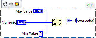

So, is this a bug??
Simple workaround is to use the Coerce Function which works properly.
Message 17 of 18
(2,781 Views)
