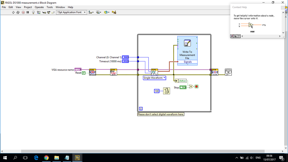

Hi Bill, thanks for your reply.
I am using RIGOL DS1052E (DSO).
Circuit diagram which i am using is following
I used instrument drivers to find drivers for my DS1000 series oscilloscope.

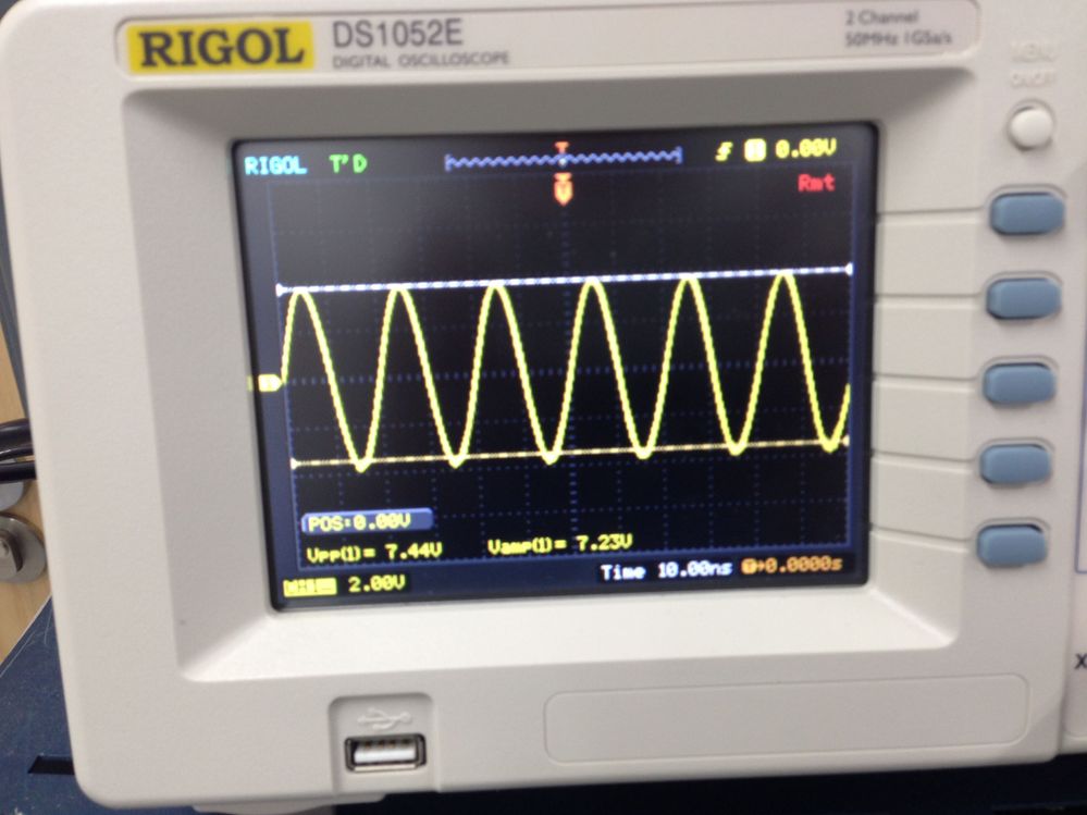

Hi GredW, thanks for your reply.
Oscilloscope is showing 10 ns. I tried to change it when i was running it through my laptop but it couldn't. Also, i changed time scale before saving waveform data but as soon as i connect my laptop to oscilloscope, it again automatically changes to 10 ns.
Do you think is there problem in my code which i am using?
I am new to Lab View, your little will be very fruitful for me.

Hi mubmeh,
When the scope changes its setting just by plugging in a USB cable then your VI isn't the problem.
When the settings change when you run the VI then it is…
You will find all needed commands in the manual of your Rigol. Compare the commands and their parameters with all settings used in your device driver VIs…

Hi GredW, sorry i can't communicate you what i want to say. Yes, problem is when i run the VI, sample time rate changes automatically on the oscilloscope, otherwise it's okay.
