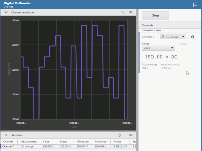

You can adjust reading rate in InstrumentStudio 2018 SP2, but it takes a couple of steps in the configuration:
1. Change the range from "Auto" to your desired range. This enables the Digits of resolution control, which can't be changed while auto-ranging
2. Change digits of resolution to a value with a faster reading rate, OR
3. Change digits of resolution to "Custom" to adjust aperture time and other advanced settings.
This tutorial talks about how the reading rate is determined: https://www.ni.com/en/support/documentation/supplemental/07/adjusting-the-reading-rate-of-a-dmm.html
