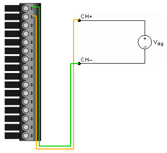

Don't you still need to ground the analog input to the power supply ground?  I don't think the AI and AO grounds are connected internally.  Picture below is for a single ended measurement.
Edit:  RavensFan already suggested this.  Oops.
