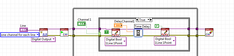

Hi Jon,
If you want to set the times separetly, my guess is it would be easier for you to create the channels separetly. It is more handwork, but i believe it's better than coming up with a time-supervision algorithm to all channels at once.
To trigger the output, I think it's better to pool the inputs, so maybe it would be good to take them out of the array as well.
In while loop, you can check the button's value and then just write 1 to the port, wait for the timeout with the time delay vi, and then wrtie 0 again.
If you create all tasks separately and don't merge error, the process for each channel will run in parallel, so one delay will not affect the other channel's action.
Mariana.

Mariana, thanks for your solution. I implemented what you suggested, and it works! I also added an indicator that lights up when a channel is in the ON state, since the way it´s programmed, only one channel can be on at one time. This isn´t a big problem for me, but it´s useful to know when the current channel turns off so that I know that I can click the next channel.

Hi Jon,
I believe you can configure the initial state in MAX - Measurement and Automation Explorer that is installed with your DAQmx Software.
Find your USB hardware and try hit "Properties". I have a PCI on my current system and I can configure the initital states.
Another way to do it is just to write all false right before the while loop starts.
Yes, there is a way to stop the loop imediatelly, but then you'll have to create the time delay vi yourself, with the possibility of stoping it when stop button is hit. This can be done in different ways. You could for instance make a for loop which waits 100ms and then configure how many times you want it executed based on your delay for each channel (number of times = channel delay/100ms). Another way to do it is to create a delay vi with the stop button reference as input. I did this vi once, and the only thing I did was to put this for loop inside a subroutine.
THe code I did is attached. You should wire stop button reference to all delays. It will have a small delay of about 150ms, but if your system is not time-critical, I believe it won't be a problem.
Mariana
