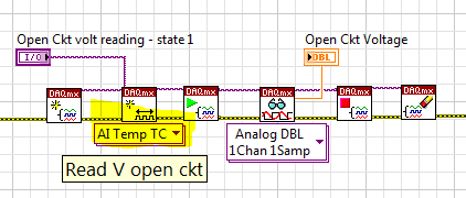

The vi takes two samples from the 6210 analog in, ch 0.
Front panel picture shows the channel input is the same, but the two readings are 10^5 magnitude difference.
There is a one second time delay between readings and a digital output goes from high to low.

Well, That would be because you wrote a bug.
Change that to AI Voltage!

Thank you kindly Jeff!
