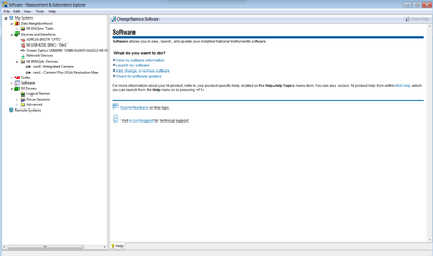

I have a similar problem. I have a Windows 7 (SP1) PC that is running Labview 2011, NI-MAX version 18.
I connected a FLIR Blackfly camera to the USB3 port of this PC. Installed the Spinnaker SDK for the camera. Checked control panel and it lists the camera as Point Grey USB3 Vision Camera.
The Spinview program from FLIR detects the camera and is able to take pictures.
However, NI-MAX refuses to detect the camera.
Ni MAX screenNi MAX screen

Do you have Vision Acquisition Software installed? If you want to use the camera with LabVIEW 2011, you will should install VAS 2015.02.
Since the camera you are using is USB3 Vision, you don't need the FLIR SDK to interface with the camera. You should just be able to use NI's IMAQdx driver. In Device Manager, you will want to make sure that the camera is associated with the IMAQdx driver.
-Jordan
Message 16 of 21
(5,899 Views)
If you have the FLIR Camera detected with the FLIR Software, then you are using the FLIR Driver.  You need to use the NI Driver.  I have a FLIR camera plugged into my machine, have just switched to the FLIR Driver (which lets SpinVIEW and FlyCapture see the Camera).  MAX shows the camera as FLIR USB3 Vision Camera "USB-0" and cannot work with it.
To switch to the IMAQdx Driver, I right-click the FLIR entry in MAX, choose Driver, pick the NI IMAQdx Driver, and now the entry says "Point Grey Research" etc., and MAX can "use" the Camera.  What fun!
Bob Schor
NI MAX cannot detect the FLIR camera at all, not even as a USB3 device, when I use LabVIEW 2011. In my machine with LabVIEW 2018, it works perfectly when I switch the driver over to the NI IMAQdx driver.
Thanks and regards,
-Reghu
Message 19 of 21
(5,890 Views)
I don't believe that USB3 was available 7 years ago (but I could be wrong!).  However, it is also reasonable to think that the IMAQdx Drivers have changed (and improved) (and maybe there have been changes to the GenICam specifications that FLIR is implementing and that IMAQdx 2018 can read and interpret).
Anyway, if you are running LabVIEW 2018, I think you should be running Vision 2018, and similarly with the 2011 versions.  You might get away with version differences of one (but I wouldn't count on it), but seven is too many ...
Bob Schor
