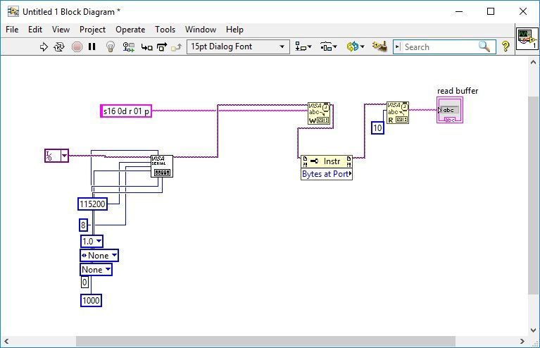

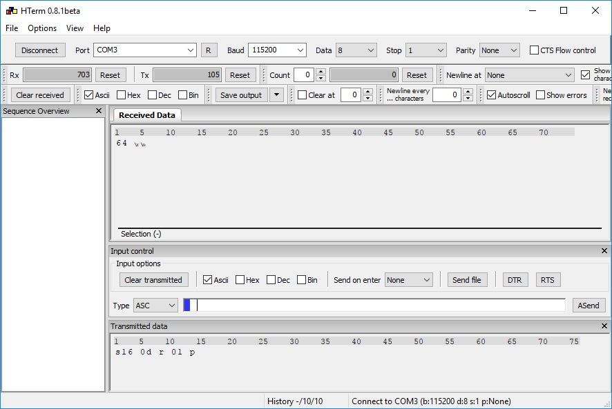

I am using  ELV Usb-i2c Interface to read the data from my battery. I am not sure how to get this data into LabView. I have tried to get the data with HTerm and it worked. Can anybody help me with a code structure, I am not sure, what I am doing wrong? I am new in LabView programming, but I learn fast 🙂 Thanks in Advance!1.jpg1.jpg2.jpg2.jpg

you need to select a COM port.
Clean up your VI and get rid of the BytesAtPort function...
