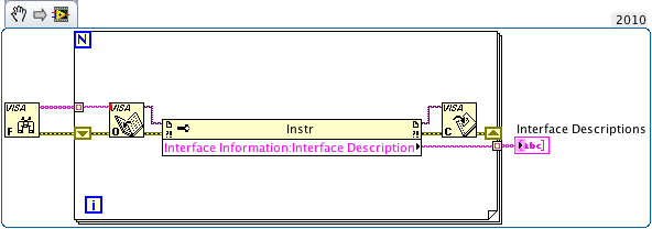

If you wire a property node up to the VISA Reference you should be able to find the property Interface Information:Interface Description. This should give you the detailed name.
If that doesnt work for you there are various other techniques such as using some calls to the .NET framework or querying the registry (providing your on Windows).
Shaun

I was able to do as you suggested, and wire up a property node and select the resource name.
However, it just gave me the com25, nothing more.
Any idea how I may read the detailed info from Windows some how??
(4,704 Views)
Oops, I would wiring error........that does give me the resource name....completely.
Many thanks!
