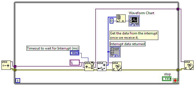

Running fast code in continous mode is quite useless.
In your code you continiousely regsiter and unregster events, this takes some time, perhaps the following code improvement will help:
I am not sure but you might be able to reuse the event.
Ton

Thanks, PTClomp, your improvement have help me to move ahead. I am able to get the continuous data with your screen-shot and putting some delay in microcontroller..:)

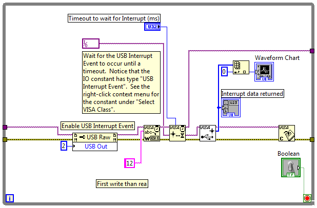

The problem is that you do a write and read simultaniously.
What error was returned by the write?
You close the VISA session, essentially killing all possible communication.
Here is my proposal (based pure on LabVIEW experience, my VISA knowledge is quite outdated)
Ton
My LabVIEW Ideas
Message 5 of 10
(12,965 Views)
Thanks TCPlomp, it works :)....now I am able to read and write 8 bytes of data continuously...do you know maximum data size the interrupt method can support?? I want to know about interrupt data buffer used in read.vi....
