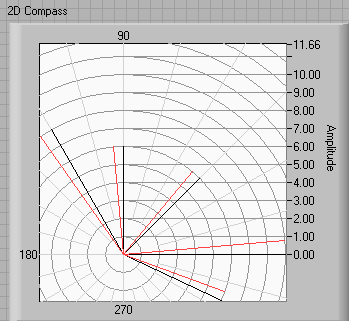

The 2d compass plot might be a good forerrunner to doing an ultrasonic phased array plot, if we could color code the values along the lines of the 2d compass plot.   Here is 2d compass plot example with a number of lines drawn at different angles:

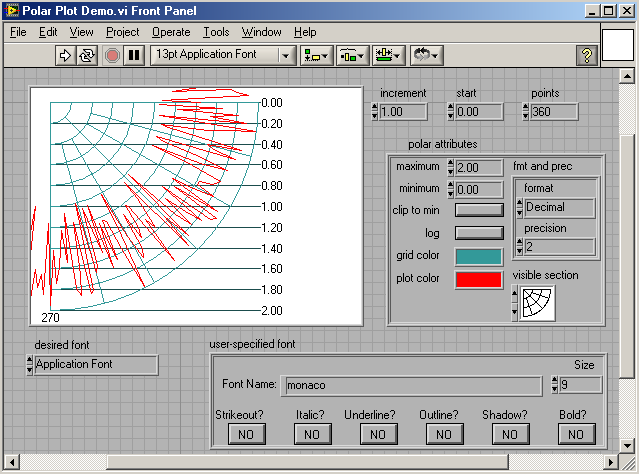

If we look at the polar plot demo example included with LabVIEW, I think it may be possible to do what I want.  I envision a number of 'polar plot.vi' fxs could be strung together with just the color representing the magnitude along a phase line changing.  This is the approach I will consider, and post when I have a result.   If anyone has any other possibilities using other graph containers as opposed to the picture control, please feel free to chime in.

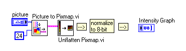

Regarding the use of the picture control, we should be able to convert the picture to an intensity graph using the following strategy. That is critical for my application.

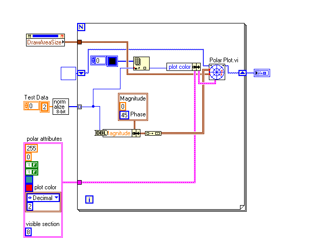

Well here is what I tried so far and I don't think it is going to work.  I think the polar plot.vi wants to see only one plot and one color.  That means this approach will not work.   This piece of code is only to plot one line at 45 deg, with each point along the line color-coded to scale with its magnitude.   And actually, what I have done here is not really what I want to do but it illustrates the idea of trying to plot multiple points using the polar plot.v.  The points really need to be plotted along the 45 deg line one at a time according to their magnitude.  That is not what I did here.
As far as converting to intensity graph from picture control, yes you could take the approach of grabbing one of the 8-bit color planes if we did start with the 24-bit depth.
