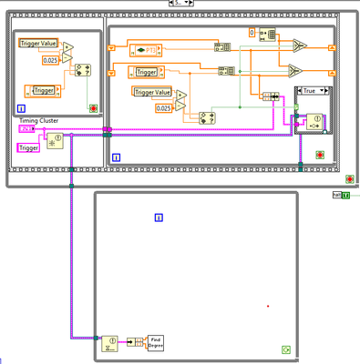

I am using LabVIEW 20. The first while loop waits for the Trigger to be in range of the trigger value. The next while loop will send a notification every time the trigger is in range. I am aware that none of the while loops have a delay which is intentional. I need a precise value that may be missed with a delay. I also tried using an array constant for the initial value of the shift register as well as sending the arrays in separate notifications instead of a cluser. Please ignore the unwired stop buttons as I gutted my code for the post.

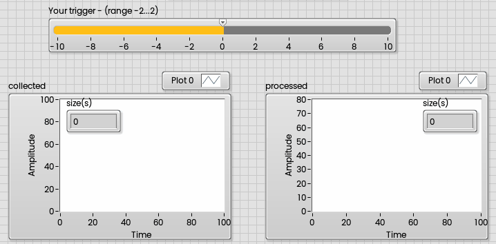

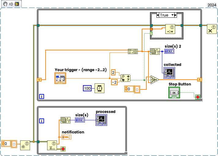

Why do not create simple VI with simulation?
and then check it:
may be your trigger continuosly in range, therefore you have always one elementh.
Message 6 of 9
(1,332 Views)

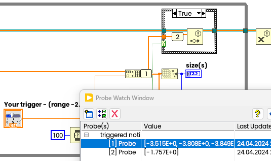

@SuperFastSquirrel wrote:
If I plop a probe right before the case statement on the array, I can see the array values I am looking for (there are thousands of values). If I plop a put a probe inside the case statement, only the first value makes it through even though the first probe says there should be more values.
I like your remake of my code
Thank you! Yes, exactly this happened, when trigger goes from high (and was here several cycles) to low. You should check last update time stamp - its simply not updating any longer:
It looks like you may need "on change" detection, then you need additional boolean shift register, then fire notification only once, and then lock next until you're in range. Then you will see multiple elemenths inside case.
Message 8 of 9
(1,318 Views)
Thank you! I added the on change detector and that worked
