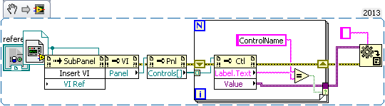

I'm so sorry. It has been a long day - I completely (somehow, don't ask) missed that you were talking about sub panel, not sub vi. You could use Property nodes to access the values of the sub vi. This method is not exactly efficient though.
Edit: You could use other criteria too.  Name, Class type, etc.  You can also write value to the control inside instead of read it.
