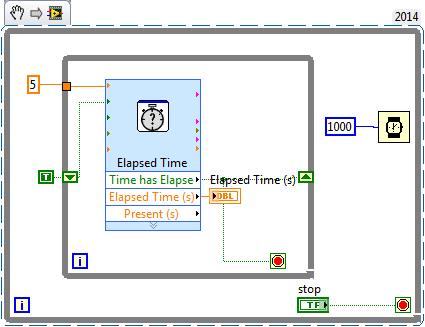

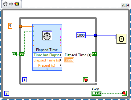

I thought I understood tunnels but it turns out I don't.
Watch thise 2 small programs for elapsed time. In the first case the timer counts up to 5 and wait for 1000 sec and restart the timer. In second case the timer count up to 5 sec and don't wait but instantly restarts the timer. Why have the wait object no effect in the second case?

This is a question of DATA FLOW.  In your first set of code, the Wait ms cannot start until the inner loop has ended.  In the second, the Wait ms does not have to wait and runs in parallel of the inner loop.

The thing to remember is that there are exactly 2 rules governing dataflow:
1. Any node with all its inputs satisfied will begin executing
2. A node will only output data when it finishes executing
So what is a node? Just about anything on a block diagram. VIs, constants, loops, terminals -- they are all nodes.
So to take your example: in the top case, the Wait node gets its delay value from a constant node. But that constant is inside a while loop node so it only becomes available when the loop finishes. So the inner loop will run, then the Wait will run. In LabVIEW terminology, this is called a "data dependency" because the Wait is dependent upon the data from the loop.
In the second diagram the constant node is outside the inner loop so there is no data dependency. Consequently, the loop node and the Wait node both have all the data that they need so they both begin executing irrespective of anything else -- including where they are located relative to each other.
Mike...

Just to be sure that I understand.
In the second case the wait object and the inner loop will execute parallel - upper sit the first one where execution is after each other

Correct.
