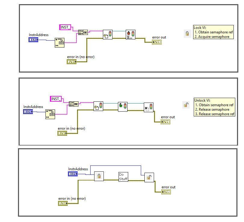

I'm using semaphores (implemented internally using queues) to protect simultaneous access to instruments. From what I understand, obtaining a reference to a semaphore and not closing it will lead to a memory leak.
I have a lockVI which obtains a semaphore reference but does not close it, and an unlockVI which obtains a semaphore reference and closes it. I would like to know if this would cause a leak. The profiler indicates that it does not.
(Note that I'm not passing the semaphore reference from the lock and unlock VI, but relying on the semaphore name)
Does labview have a garbage collector which releases the memory in the lockVI? Or does the semaphore reference the lockVI get freed when the semaphore gets deleted in the unlockVI?
If I were to release the semaphore reference in the lockVI, the semaphore would get deleted. Is it possible to clear a semaphore reference without clearing the semaphore itself even if there are no other references existing in memory?
Thanks in advance.

If you look "under the hood", semaphore references are actually queue references!
And the way queue references work is that LabVIEW drops the queue from memory if either:
1. It "thinks" all VIs that call it are done using it
2. It gets the same number of calls to "release queue" as it does to "obtain queue"
3. "Release queue" is called with the "force destroy" option
With the code you have, and NOT passing the semaphore reference, you're calling the "obtain" twice as much as you are "release", so yes, you could have a memory leak unless you start passing the reference or saving the reference somewhere (FGV, global, etc.).

LabVIEW will free the semaphore reference(s) when the top level VI stops (hierarchy is Idle) so until then the references won't be automatically released unless you explicitly do so (via the Release Semaphore Reference VI).
That's a named semaphore reference so you're always getting a new reference to the same semaphore instance with Lock and Unlock but only freeing one of those references in Unlock. It will also mess up the ref counting so you don't get automatic semaphore release. Have a read this: https://lavag.org/topic/9722-obtain-queue-memory-leak/.
I can see that you are trying to change the syntactic behavior of the usage of the semaphore, presumably so that the caller need not concern itself with the semaphore ref wire. Ironically though you still have a wire involved going to both VIs ("InstAddress") that must contain an identical value so I'm not sure what you are gaining - you would be better off just using the ref wire between the Lock and Unlock VIs.

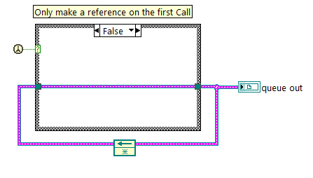

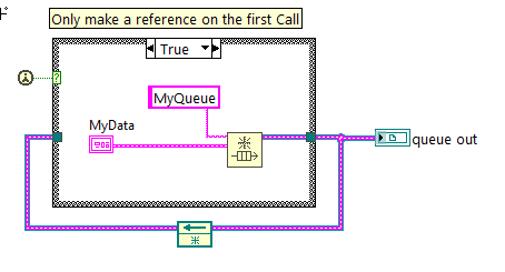

There are times that I use named queues from different places and I do not want to always make a new one and close the old one in order to prevent memory leaks. I use a construct like below so only one reference is created. At the end of your program you use Force Destroy, or destroy at the end of a process individually.
mcduff
