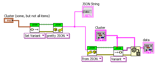

@Richard_Ha wrote:
Also the attached snippet takes a complete JSON string and populates a partial cluster, not a partial string and populate a complete cluster (though I've not isntalled it to see if it would do that).
It'll work in either direction:
