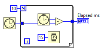

There are several problems with your code.  Some have already been mentioned, but there are other problems (more fundamental).
  • There are several "timers in LabVIEW.  Since you are wanting to "do something after a period of time has elapsed", you do not need a "High-resolution Timer" that can report times in fractions of a microsecond (as a Dbl) -- a timer that gives you a count in milliseconds (as a U32) will do.
  • Did you notice (by reading the Help entry) that the High-resolution Timer (being derived from the same PC clock as the TimeStamp) is in seconds, and not milliseconds?  Multiplying a time difference by 1000 gives you "Elapsed time in kilo-seconds", a little weird.
  • If all you want is the current runtime of the program in ms, do the following:
    • Outside the While Loop, drop a "Tick Count (ms)" (the first Timing function in the Palette).
    • To compute the elapsed time inside the loop, drop another Tick Count (ms) and subtract the first Tick Count (brought in through an ordinary Tunnel).
Here is a Simple Elapsed Timer example.  I'm deliberately saving it as a simple "picture" to encourage you to open the Timing Palette, look at the offerings, drop down some of the functions, and read the Help to understand what they do.  Then predict what the value of "Elapsed ms" will be -- I almost guarantee you'll be off by at least 8 ms.  For "Extra Credit", explain this.
 Bob Schor
(802 Views)
