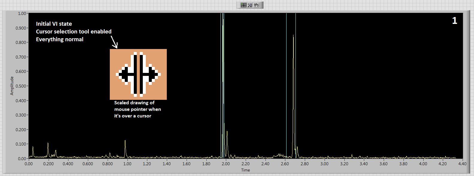

I'm hoping someone can identify a graph "tool" that's interfering with my LabVIEW program.  It's not on the normal graph palette and I can't find reference to it anywhere.  It activates seemingly on its own during runtime, and sticks around if I abort execution (its behavior appears to be coded into the graph itself).  I wasn't able to take a good screenshot of what the pointer looks like when the tool is active, so I've included a scaled-up drawing below (pointer is the black/white parts).
Some additional details:
- It usually activates when the mouse point hovers over one of the cursors on my XY graph (but only under certain conditions that are not 100% reproducible).  The graph cursors are free dragging, and the tool has only activated when I had more than 1 plot on the XY graph.
- If I click on a graph cursor when this tool is active and drag in either the +/- Y direction, the Y scale min/max values change to seemingly random values and the Y scale begins scrolling up.  Nothing happens if I move the cursor in purely the +/- X direction.
Much thanks in advance.

I recently learned something useful though: the mouse pointer (icon) in question is identical to the one that appears when dragging an annotation on the graph (or just hovering the mouse pointer over it).  However, the cursor state issue exists even when the graph has no annotations on it.
I'm fairly certain this is a bug.

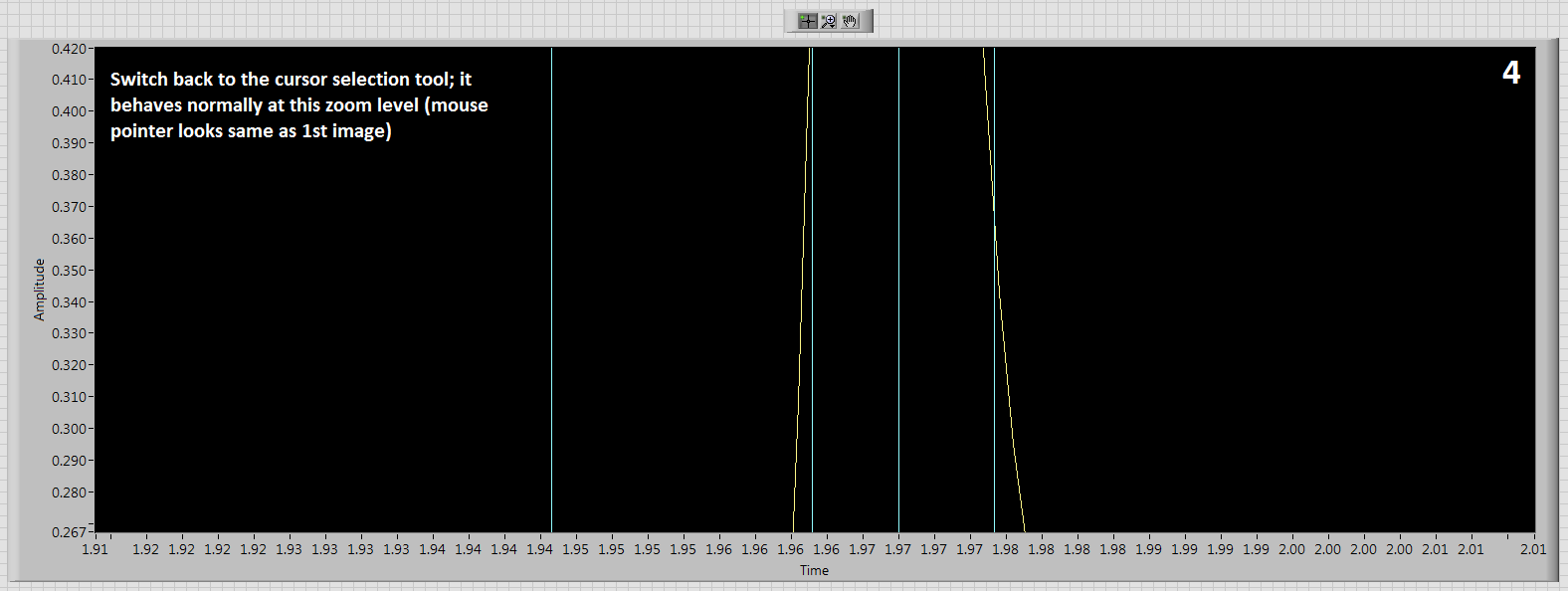

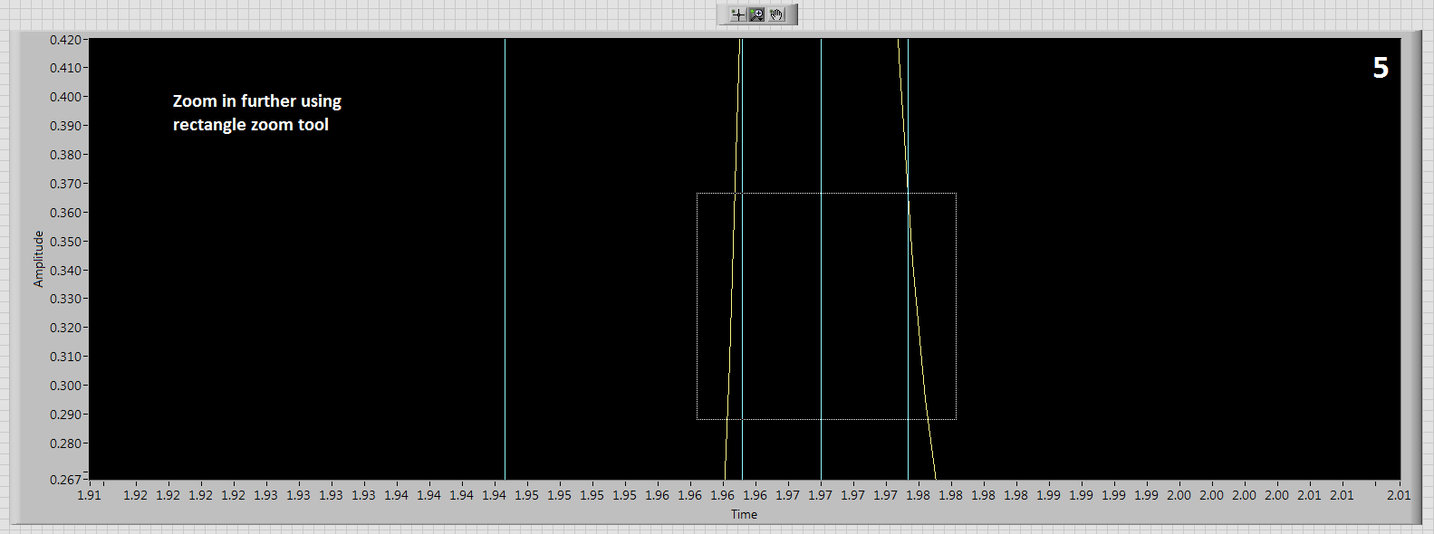

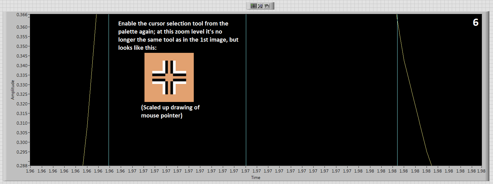

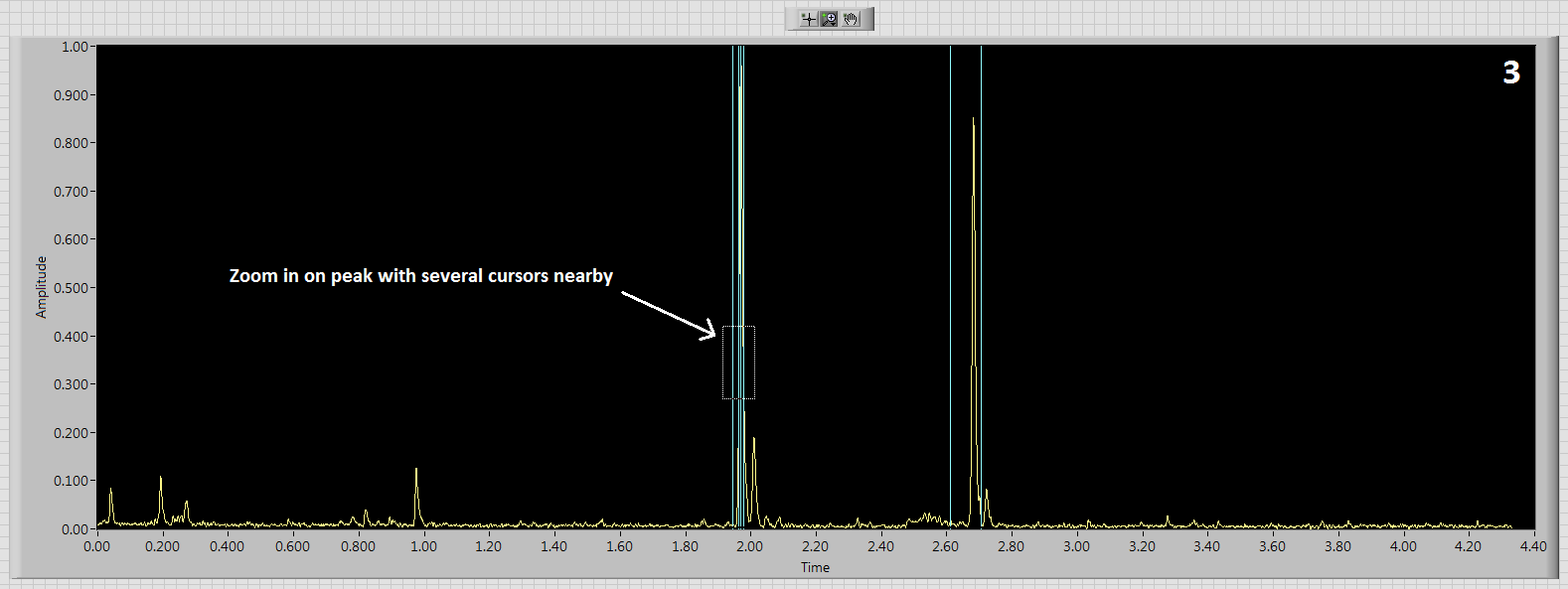

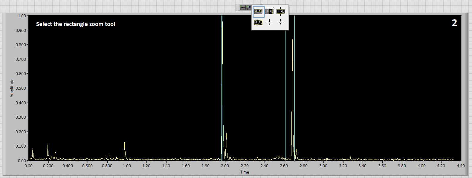

Okay, I've been able to reproduce the problem consistently in a much simpler VI (attached).  It only contains is a single XY graph, with no code on the block diagram.  There's some data saved on the graph, and I put a bunch of cursors on it.  When I follow the steps below, I've been able to reproduce the issue 100% of the time.
I should note that I'm using LabVIEW 2014 Professional (64 bit) on Windows 7.
