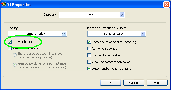

Set VI properties>Execution>Allow debugging>
(4,327 Views)
"Allow Debugging" was already checked. When I click on the block diagram while the vi is running I hear the classic "dong" noise associated with a unresponsive application, but the vi continues to run.
