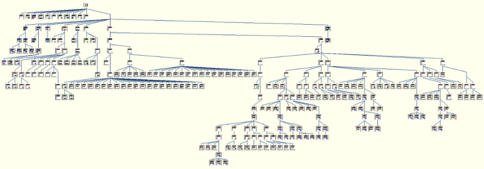

That's hard to say. It is not that complex. I think other languages e.g. C++ can handle this easily.
Class HierarchyClass Hierarchy
 But we do have same issues with smaller projects.
