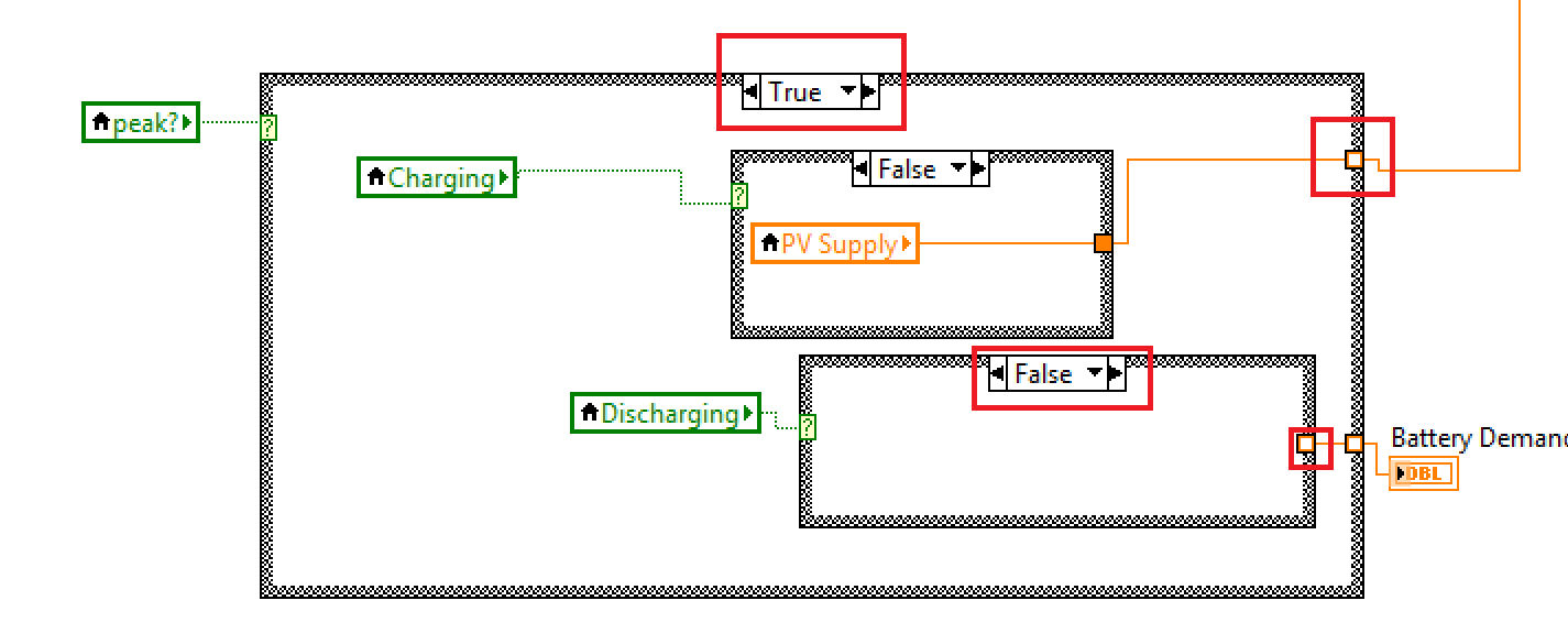

I am having trouble with case structure. I am not using a few case, I tried to remove the case. By doing so I recieved an error msg "No case for some selector value". I also tried to leave the case as it is and there was also a msg of "tunning:missing assignment to tunnel".

When you use a Boolean as a case selector you will have only 2 cases and both must be present, removing a case out of this doesn't have any use case of a case structure altogether. The "missing assignment to tunnel" is because you pass value out of the case from one case and on the other case the value is undefined, you must right click the tunnel and select "Use default if unwired".
