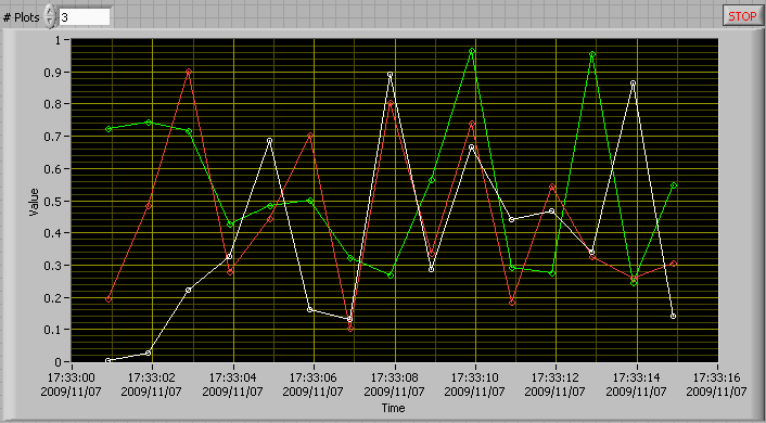

 The demo's front panel, with three plots being updated once per second

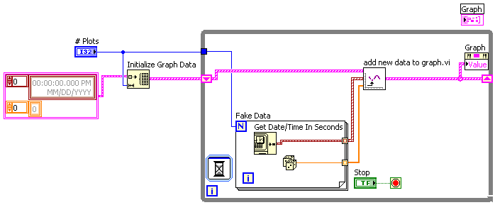

The demo's block diagram

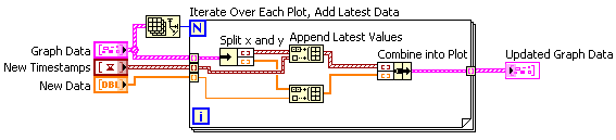

The SubVI's block diagram

Look in the help for "XY Chart" instead of "XY Graph"!
It's the same control on the front panel, an XY Graph, but the code behind make it act as a chart, just what you need, add one point once in a while.
You can handle XY Graph in two ways:
In case you get all points at once: Then use a cluster of two 1D array's, 1 for X data and 1 for Y data. In case of multiple plots, just build a 1D array of clusters.
In case you get one point at the time: Then use a 1D array of clusters where each cluster contains X and Y data of one data point. In case of multiple plots, make a cluster of that 1D array and place it in a new array.
Reading your post, you have the second option but use the first data structure Smiley Sad
