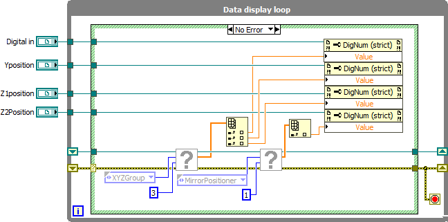

I have attached an example of a UI that I would like to use in multiple VI's and it would indeed look like what you explained as a fake variable. How would you do something like this?
Message 11 of 15
(795 Views)
Obviously, this is a simpler scenario where you only write. If you want to read/write in the subVI, you could do it as action engine, keeping the data in a shift register and read from there instead of the front panel terminal. All it should do is write to the terminal and keep the data local (not shown).
You current code could easily be simplified as follows (note that index array is resizable, returns the elements in order and that you can wire an error directly to the termination condition):
Personally, I would even use an array of references (One connector instead of four!!!), especially since all are of the same type.
Message 12 of 15
(779 Views)
This doesn't look like a "fake variable," but based on this example I wonder why you think that you need to do the UI update inside the subvi. Bring the loop outside of the subvi, ditch the references and DVRs, and pass the data points out to be updated at the terminals (I would likely pass them as an array).
As a side note, you can expand the Index Array to get more indices in one Index Array. Also, they will by default start at 0 and increment. No need for multiple Index Array primitives to index data from the same array.
That looks so much cleaner, thanks a lot. What would be the difference in doing this by reference or by variable?
