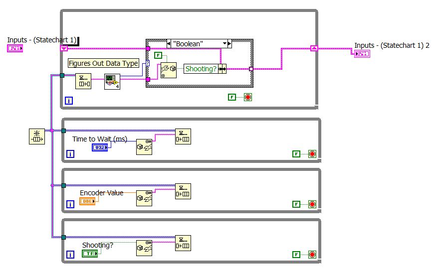

This is not a real code beacuse I'm just testing a new way to code a robot, but we can discuss the issue using this example.
The loops are running in parallel and each of them is updating a specific cluster element without cahnging the others.
The controls represent the new data.

What else accesses that global variable? More than you show?
Use a non-reentrant subVI to keep the cluster in an action engine and do the updating. How many elements are there?
You could use an additional loop that keeps the cluster in a shift regsiter and use queues to replay update information form each loop.
You could also use a data value reference for the cluster.

There is a main loop that reads the cluster into a subVI, and there might be other sources that will update the cluster.
Can you give me examples for your solutions? I don't think I understand how to implement this.
I'm using a cluster beacuse LabVIEW statecharts accept a cluster of inputs which I want to update from various sources.
A global variable is what I know so I tried it.

Yeah, sorry about that.  It dawned on me what it was you were asking after I posted.
This is a solid solution.  Quick mock up.  You can do thing bundle the data with its data type and queue that, then use that info after dequeue to determine which value in the cluster it needs to go to.  But this will certain remove race conditions.

I still think my suggestion of using data value references would be simplest. The IPE structure will block concurrent access to the data cluster: No race condition.
The last loop (optional) shows how to query the state of the data cluster.
