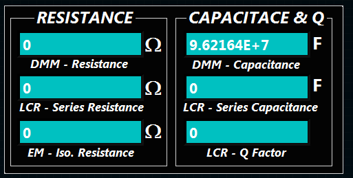

For example, I have this clustor shown below with 6 numeric indicator fields, but when attempting to update a single field, the other field is reset to 0.

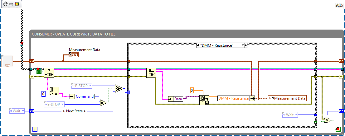

The first iteration of my program grabs the data and updates the DMM - Resistance indicator as shown below....

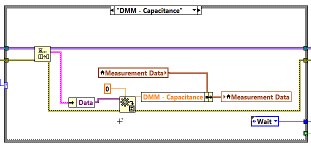

After this, I add into the queue to update the DMM Capacitance field in the same format...
And when I update the Capacitance field of my clustor... the Resistance field returns to the value 0.

It looks like it should work, can you post actual code or a snippet?
Also, can you select the case statement in question and press the "Clean up diagram" button"?  Not that your diagram is messy, but if you have some weird wiring or objects hiding under other objects it will reveal it.

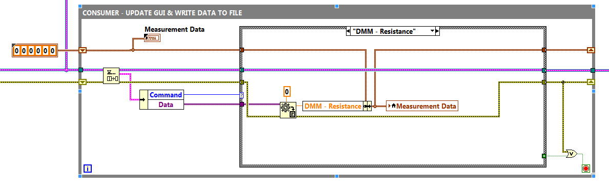

The two fragments you posted, showing reading/writing a Local Variable, suggests that you can, and should, use a Shift Register, instead.  Try this (there are some things that show "dimly" because I don't have your TypeDefs) --
Notice that (a) Measurement Data is initialized (by the Cluster Constant connected to the input to the Shift Register), (b) the Measurement Data is updated on every change, and (c) there are no Local Variables anymore (generally a Good Thing).

Well you still left a Local Variable there in the Case Statement. Can that be removed?

Yes, of course -- I meant to delete it.  I did delete it in the other Case, I think -- this was just carelessness on my part, sorry ...

1. No need for that local variable inside of the case structure.  The indicator will update with the next loop iteration thanks to the shift registers.
2. You had a weird state machine going.  What you have here is A LOT easier to understand.  You just now enqueue all of the states you want to go into and in what order.  If you get an E-Stop condition, use the Enqueue At Opposite End to make sure that is caught immediately.
