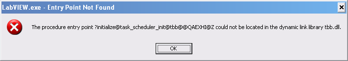

I just try to update a LV software made with 2009 to 2010 (same PC). I try to open a reference from a homemade ActiveX. In 2009, everything is fine. In 2010, I got this error
21343i3CBB27D831312AD1

So here's what I've found out:
1) Having multiple versions of the same dll on a computer can cause the Not Able to Locate an Entry Point issue
2) The RTE you provided installs tbb.dll here: C:\Program Files\MATLAB\MATLAB Compiler Runtime\v710\bin\win32\
3) tbb.dll is also installed in C:\Windows\System32
4) The versions between these two locations are different and looks to be what is causing the problem
The preilimnary workaround is to rename the tbb.dll in System32 to tbb.dll.backup so that it doesn't get lost and then copy the version from your RTE into the System32 folder. This should get LV 2010 working although there are some caveats. If you do this, you will not be able to use Vision Builder AI and most likely the Vision RTE because they have similar dependencies. If you do not have either of those packages, I would not worry about those. The other thing is that the dll will no longer work properly with LV 2009. We know this is not ideal and are looking at other ways around this.
