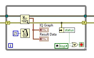

 If I understand correctly, the error only appears after a couple of seconds, which should mean that the VI works on the laptop and you gather some data, it just fails to be fast enough to process it all and eventually, the internal buffer of the task fills up. Could you run the task at a lower speed? That would make it certain whether it is caused by lack of system resources. The architecture you implemented looks good so far, I have some suggestions though:
-Try moving both data displays out of the producer loop, because updating them every iteration might take a bit of time. You can create a third loop for display like so:
the Preview Queue Element ensues that the queue is undisturbed and written to file without loss, and the Wait makes the display update at 50 Hz which is more than enough for fluid display yet still preserves resources.
- I would also move the control for Number of Samples out of the loop, to avoid front panel communication at every iteration.
- I suggest to set the Number of Samples to a multiple of 360, to ensure that all packets are of maximum size.
If all else fails, you can test your applications by ignoring overflow errors. To do this you must set Configuration>Advanced>Warning Policy to Return Success with a Property Node.
I hope this helps, please get back to me with the results.
