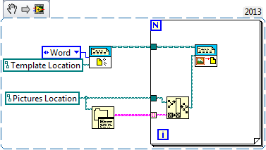

I am writing a number of (.png) images from a bigger image dataset to a MS-Word report using Append Image to Report. The dataset is hosted on my drive. Now, that I want to build an application for my VI, I figured I should convert my complete image dataset to an image data constant, and thus remove path dependency. But the Append Image to Report VI only accepts path or url for writing an image.

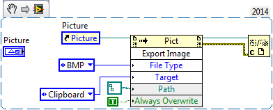

The Report Generation Toolkit VIs like this one are very limited. If you dive in to the VIs, you'll see that you can manipulate the Word document yourself using the lower level Invoke and Property nodes. I've created a lot of report generation code that uses mostly my own nodes for manipulation, but it's very helpful to use the Report Gen Toolkit VIs as a starting point.
One way I bypassed the path issue in the past was to copy the image to clipboard and then paste where I wanted in the document using Word Find and Replace.
Here's how you can copy the image to clipboard. You'll notice it just uses a Picture control. No path needed.
To paste, use Word Find & Replace.vi and wire "^c" to the replace-with input.
